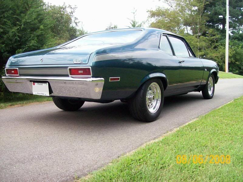

I am thinking about changing the look of my 70 Nova from the current drag look to the pro touring look. I want to go with torque thrust II wheels and lower the car maybe an inch or so. Can someone give me the run down on what rim size front and back, back spacing front and back, tire size front and back and lowering method? Any help would be great.
here is my car as it looks right now.

if you really really want to be safe run a 255 on the rear, i ran 275 on an 8" wide rim even against tire maufactures suggestions and i had no problems, but i was using a falken tire thats a small 275/40 series, went to a 275/40 nitto on my 18x9's and are a .5" taller tire..you picked a good rim size for the rear, but are your qtr panel inside lips trimmed? also depending on how much you lower the front end ( with stock upper control arms) your tire will some in contact with the fender liner bolt, i would have recomended at least a 4.5" on the front...but i will say this again it all depends on how low your car is. for whats its worth i dont know anyone on any site that has changed the suspension on there 3rd gen more than me. my list is huge. if you have a quesition feal free to ask.
this was my car 2 years ago with the very same bsp and rims you mentioned

Thanx for all the info. My rear lip is still there. No trimming away, no rolled or rust. The car is all stock suspension. Did you mean 255/40's or 255/ 45's?? Do you think I will have troubles in the front with a 4" BS???
What tire do you suggest for the front..

I would recomend a 255/45 however they will be really tall, which will give it the old hot rodder look. the 255/40 will be a tad bit shorter. If the rims havent been built yet and your not running big rear disk brakes a 5-5.5" would be a good rim, just because if you plan up grading you have the room to do it.
I run a 18x9 with 5.75" bsp with no problems however my fender lips are trimmed. I wanted to go 6" bsp just because there is still more room on the back side of the tire but i'm glad i didnt because i wouldn't have had room to clear the calipers...
this will give you an idea of a BIG 275 on my rim combo, as you can see my fenders are trimmed, there is a decent amount of space with them trimmed ( even though it doesnt look like it) but with an untouched qtr panel it would be stuffing
