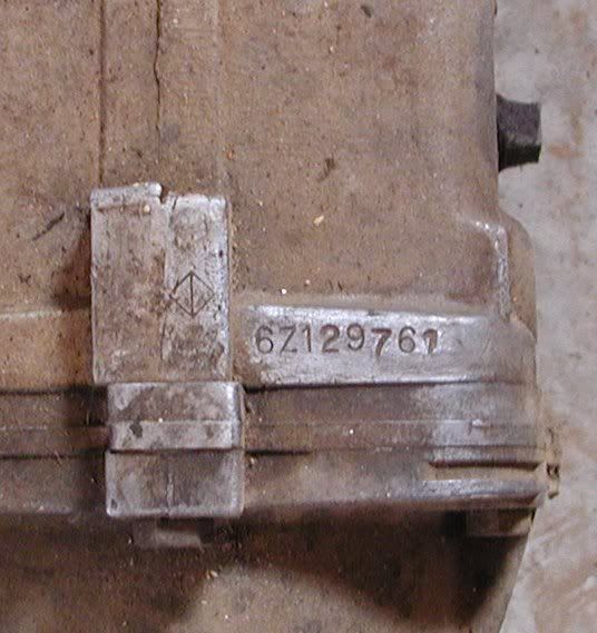

The Muncie will have a partial vin stamped onto the main case. It is usually on the top and hard to see. Using a mirror you should be able to check.
