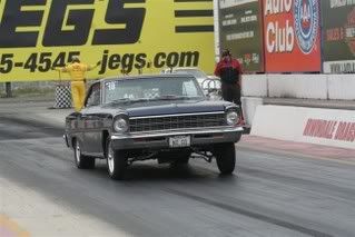

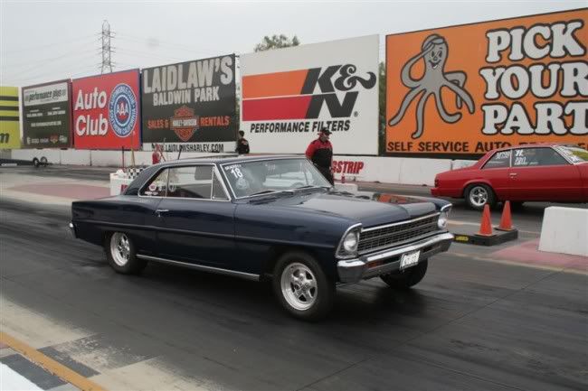

Well I went to TNT yesterday with Teddisnoke for a little draggin fun at our local 1/8th mile. All this time I have run my car successfully with no traction device, until my VIOLENT wheelhop began yesterday! My car would launch hard but the springs would unwrap and instantly send me into some nasty wheelhop. Also, my MPH was the same (within .5 mph) as my previous runs at that track.
So its time I bought some traction bars! Ill probably just get some slappers and see what happens. I did find a guy selling a set of Caltrac bars and springs but they are from a 70 Nova. Does anyone know if they are the same for a 67?
Heres a couple pics for your viewing pleasure:
