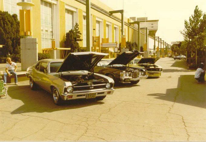

Here's my "old" '72 Nova which was converted from a 250ci inline 6 to a 402 big block in 1979-80. Don't worry...it's not around anymore :(
1971 402 ci, 8.5 to compression, Turbo 350 with Art Carr shift kit, Crane Fireball cam, Edelbrock Torker 2-0, 3310-2 Holley, 3:73 posi out of a totalled '69 Z/28, cheapo Blackjack headers and ran on unleaded gasoline.
The last I heard, the engine was in a Pro Street car...and the body was rusting away on 9th street in Anaheim, Ca.
These pictures were taken at the Street Machine Nationals West in Pomona in 1981. The time slip was from Orange County International Raceway.
