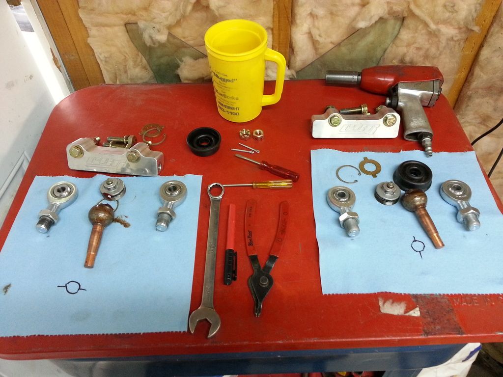

Work began to get parts on the car and out of the way. Front end first, the CBR suspension and steering is great. really easy to install no modifications are needed to the car, everything bolts on and looks good. I have seen first hand how it improves the ride and handling.

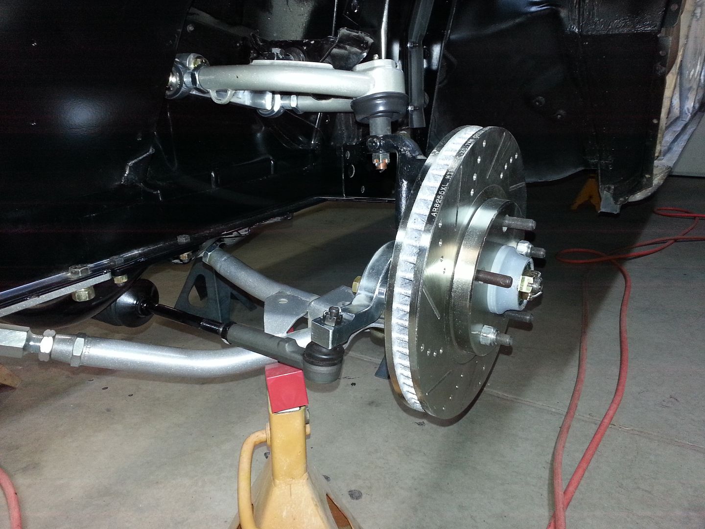

Brakes will be next, 4 wheel disc from an 98 - 02 F body. CBR mounting bracket installed on front spindle. Conversion uses the stock 5 lug spindles and drum hubs from 64 - 67 Nova, 12" rotors front and rear, 2 piston calipers in front, single in rear all from the F body. Waiting on new wheel bearings, will post the brake install later this week.
