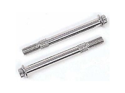

Starter Bolts are different!
The knurled section fits tight within the block as the bolts press themselves into the softer cast iron:
