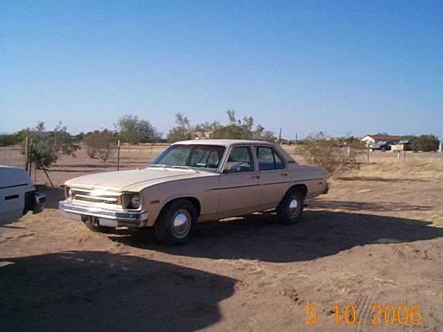

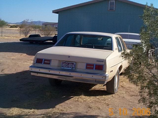

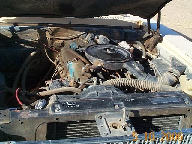

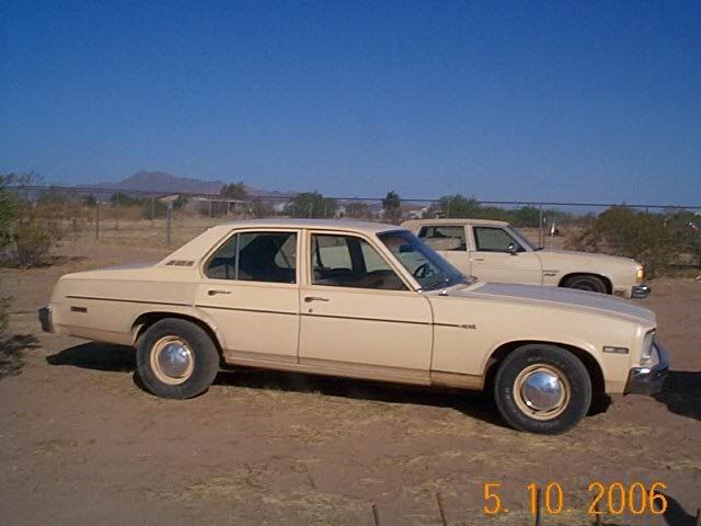

Yesterday I picked up a 78 4 door to use as a donor car for my 75 project. The body ia almost perfect, there is a small dent between the wheel opening and rear door on the right side and thats about all of the damage. I wanted the front fenders and bumpers for my car and maybe to sell enough of the rest to break even. It is a base model car, 250/3 on the tree, but it has some interesting options. It has the heavy duty cooling system, a big radiator and large opening on the core support. I know it is factory because the emission label is still intact and the fan shroud is much smaller than the V8 . There is also an 8.5" differential under the car. Unless the factory ran out of 7.5" it had to be special ordered or replaced. I haven't checked the numbers on the axle tube, so it may have been replaced at some time. No A/C, no power steering or power brakes. Here are some photos.
