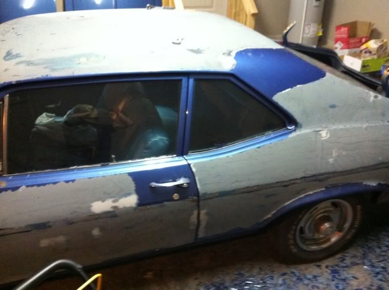

the paint was almost "lifting" in areas and chipping badly in others, so it simply wasnt going to work. I had once read somewhere that on poorly prepped paint jobs you can little scrape the paint off with a razor blade so i figured what the hell, invested a steep $2.00 in a scraper and $1.50 in a pack of refil razor blades for it. the pictures pretty much speak for themselves
shows how the paint was litterally peeling back
after about 2-3 hours of scrapping away this is how the car sat, although the other side on the rear quarter the paint wouldnt scrape away like it would the rest still need to do the hood fenders and trunk

So far i have been pretty lucky with the rust, the drivers side floor pan needs some work so cut that out
the only "suprise" hidden under the paint was this little gem of rusted out area patched with pure bondo
Currently been working pretty long days but starting to sand the car
The most interesting thing is all this time i thought i had a just quicky paint job sprayed right over the top of the origional and it was lifting because the surface wasnt prepped the right way. Well once i scrapped off the paint it appears that the primer they used actually adheared properly to the origional paint, it was the new paint that didnt at all stick to the new primer, i'm no expert so cant truly say why at all, but the body work itself and filler that was applied seems to have been done pretty good but i am no expert. Anyways what i do know for sure is that new paint was sprayed VERY thick and is going to be a lot of work to sand it off the quarter on the other side where it wouldnt scrape off.

Ok so update as you can see from the pictures I am not taking the car to bare metal as the original paint underneath is in good shape, but you can see in some areas I did hit metal while stripping the car down so far, just the nature of the beast. Unfortunately I am going to be heading out of town unexpectedly for almost 2 months and while it's stored inside in a garage don't want to leave those metal areas exposed in fear of coming back to a bunch of surface rust on those areas. I am somewhat lacking in knowledge on body work but won't have time to apply filler where needed and patch the needed areas before I leave so don't want to spray my primer. Would just some cheap cans of rustoleum spray paint do the job to somewhat seal the car for the time being until I can get back? Then I would just sand that off do body work and spray with actual high build primer from a gun. Any thoughts and knowledge will be appreciated

I would recommend Rustoleum high zinc primer that they sell at the big box hardware stores. It will stop rust in it's tracks.

well small update still just sanding down all the old paint, probably wont take the whole thing to bare metal as the origional paint underneath seems to be in pretty good shape. As you can tell from the first pictures i posted the roof and drivers are pretty straight and in pretty good shape. Unfortunately now that i have moved onto the passengers not such luck. Still no rust to be found which is good news, but most of the quarter had bondo. Luckily as i have been sanding away most of the bondo is just a skim coat to cover up minor imperfections and no large dents or defects yet. The worst news is the passengers side door is pretty warped, it was like this when i bought the car and i'm not totally sure i will be able to straighten it out completely, so may just opt to reskin it, still have to look a little closer to see just how warped it really is.
Next will be to scrape then sand the fenders and trunk lid, planning to use a fiberglass hood so i wont waste time on the current one. The plan right now is to paint the car satin black.
